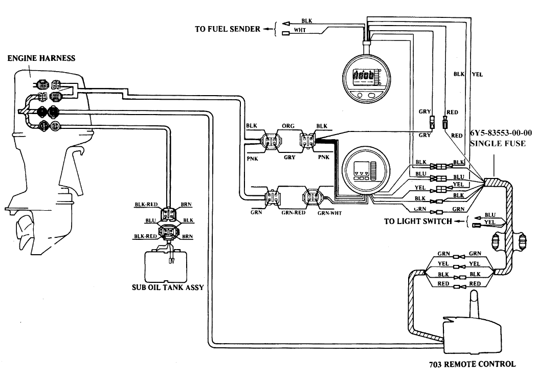

Thanks for the diagram, it has no battery, supply details and with no display at all I'm leaning towards a supply prob or the gauge itself
Originally posted by Peter Andrews 2 View PostThanks for the diagram, it has no battery, supply details and with no display at all I'm leaning towards a supply prob or the gauge itself
maybe the diagram?
and what do you not understand about Boscoe99 saying the gauge you have is not designed to work with your 1999 model motor?
