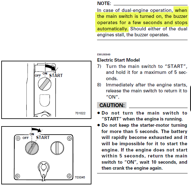

it was my understanding water in fuel filter quits alarming when put in gear. I am not sure on what models.
if that is what this is and you swapped the filters between the motors and it did not change, then maybe a wiring problem( shorted wire)
