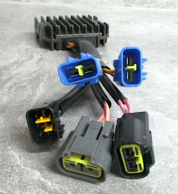

did your RR and drive units have the blue connectors( meaning they were the new design)

can anyone tell me if the drive unit for the f225 2003 is the same as the f225 2006 - the parts appear identical (wire colors and connectors) the part numbers above are off by 1 digit - I can get my hands on a used one quickly the other part is back-ordered and the summer is slipping by. Any help greatly appreciated.Originally posted by Larry Onisto View PostFound the part number for the drive unit 69J-83306-00-00 through boats.net with the notice they are currently unavailable. Found similar part 69J-83306-01-00 from other sources so will try to source one with the assumption the difference in numbers is just a higher revision of the same part. I will get it and see what happens and hope I dont find myself in the same boat as scubasteve on the first post. Again any advice appreciated.
They are definitely NOT the sameOriginally posted by Larry Onisto View Postcan anyone tell me if the drive unit for the f225 2003 is the same as the f225 2006 - the parts appear identical (wire colors and connectors) the part numbers above are off by 1 digit -
The drive unit used in the "2003 Model" - 69J-83306-00-00 -
had only one connector to mate with the R/R used
(the Drive Unit has 4 total connectors)
That Drive Unit is no longer available (from Yamaha)
"presumably"
because the R/R it mated with was problematic!
For 2004 and later, both the R/R and Drive unit were changed: drive unit 69J-83306-01-00
and they connect with TWO plugs.
(the drive unit has 5 connectors)
99Yam40 has posted above (post #25) a link to a post I made
with photos explaining the changes from 2003 to 2004 and beyond:
https://www.yamahaoutboardparts.com/...-boscoe-and-99
did your old driver and RR have the blue connectors?Originally posted by Larry Onisto View PostThanks to all for your input as I now at least have a reasonable idea of how the charging circuit works, new driver just arrived 69J-83306-01-00 and will install in the next few days. Hopefully it will be plug and play.
