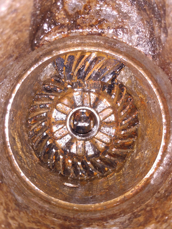

oh..I forgot..the pics of it when i pulled the carrier bearing says, it exceeds the file limit...how do i "cheat that" so u can see how nasty/corroded this thing was..any ideas boys??? come one come all..metals my friend...these computers...thats a bird ofa different feather to say the least .lol
Make a free account with https://postimages.org/ . Upload your pic's, then use the option "hot links for forums" and it'll show a big pic, not the little ones..Originally posted by sea-nile View Postoh..I forgot..the pics of it when i pulled the carrier bearing says, it exceeds the file limit...how do i "cheat that" so u can see how nasty/corroded this thing was..any ideas boys??? come one come all..metals my friend...these computers...thats a bird ofa different feather to say the least .lol

Hello,Originally posted by 99yam40 View Postquestion I have is, what did you do to pull the carrier and prop shaft
Use this one to pull the bearing housing of lower unit
