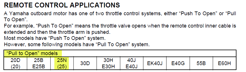

to move the throttle lever you mounted on the motor forward as you said,
would mean that the cable would need to get shorter( retract), so my thoughts that would be a pull
