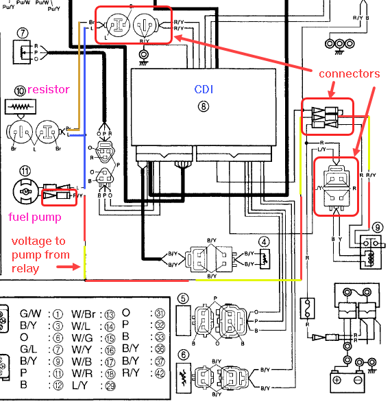

    I am not understanding the voltage going away part. Are you measuring voltage on the red/yellow wire to the fuel pump?
    Jumpering the fuel pump blue wire to ground, resulting in the fuel pump continuimg to run, leads me to believe that the fuel pump has voltage.
    The same red/yellow wire provides battery power to the fuel injectors and the O2 sensor. Is voltage missing at those components as well?

            The voltage at the pump should be battery voltage/system voltage. Bad connections can result in excessive voltage drop.
              The pump is grounded by the CDI but through a resistor at low RPM's. Via brown wire.
              Above low RPM's the pump is grounded directly by the CDI. Via a blue wire.
              I would inspect the electrical connector from the CDI that supplies the grounds to the resistor and oil pump.

                      if the CDI thinks the remote oil tank is low, it will not allow that pump to fill the tank on the motor.
                      too much oil to the fuel needs to be looked at by itself.
                      I have no idea what controls that on this motor.
                      strange that you say that the VST is full, is it full when the motor dies ?
                      Are you saying that the pump in the VST is just stopping when the motor goes above 1200 RPM
                      something has to tell the CDI what RPM it is running at and to switch over to keep the pump running all the time.
                      might try hand tracing the blue wire and measuring the Ohms of that wire from the CDI to the pump.
                      you need to know if the CDI is giving that wire a good ground or not, and if that good ground is traveling all the way to the pump.
                      bad connection in-between, bad wire itself, or the CDI is not furnishing the proper ground.

                              HPFP runs and puts out 38 psi up to 1200 to 1500 rpm’s +/- a couple hundred. After that there is 12 9 volts on the + terminal of the HPFP but no continuity to ground on the - terminal of the pump so the pump simply stops and the engine dies while the VST tank is still full of fuel.It I ground the - terminal directly to the battery negative on the block then the pump continues to put out 30 psi or more and the engine runs from 0 to 4000 rpm’s and never misses or tries to shut off. So based on what you guys have taught me I assuming the Computer is cutting the ground for some reason above 1200 when it switches from the resister ground loop? Or simply a bad wire or connector between the pump and computer could cause this as well ?
