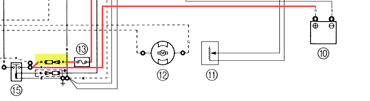

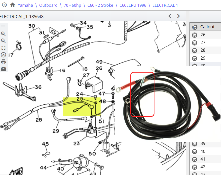

Now that the motor is mounted, I have no power at the forward control (Electric choke, starter all dead). I can start the motor with the pigtail disconnected by jumping at the starter relay but when connected it will not start. When I found the 20amp fuse that came out of the broken clip. It is on a red wire coming out of the pigtail and is followed by a lead that is not connected to anything. When I examined the Electric Diagram on the Crowley parts site, it shows the fuse and the lead but it does not show where it might connect. Is this pigtail intended to hang loose? Should it be connected somewhere?
