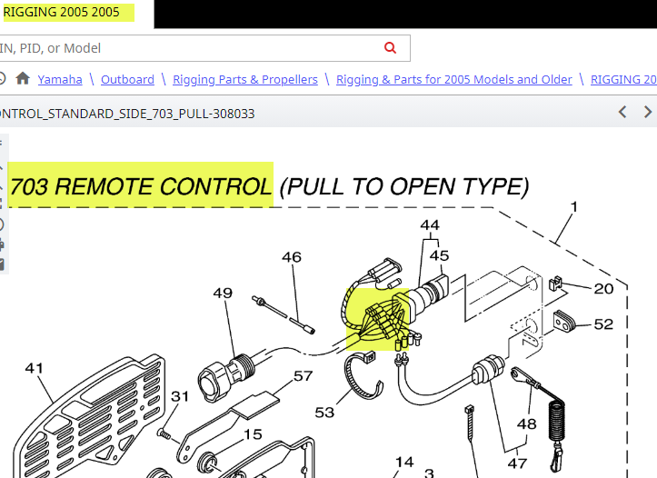

          The remote control is a Yamaha 703.

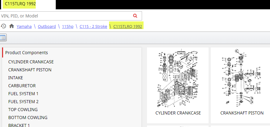

            do you think you can point out what the motor is on this place?
            I do not see a 2003 C115 Q there
            Yamaha - Outboard - 115HP OEM Parts | Boats.net
              Not 2013, 1993. Thanks.
