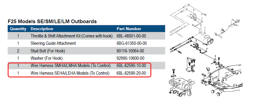

    Hi all, I bought a used 2020 F25SWHC tiller model and am converting to a remote set up with the 703 side mount remote control. The mechanical part is hooked up but I don't seem to have a 10 pin connector for the electrical harness on my engine??? does anyone know what what I am missing? can't seem to find anything on the internet for this situation, and the install manual for the 703 remote control doesn't mention anything about wiring ... thanks

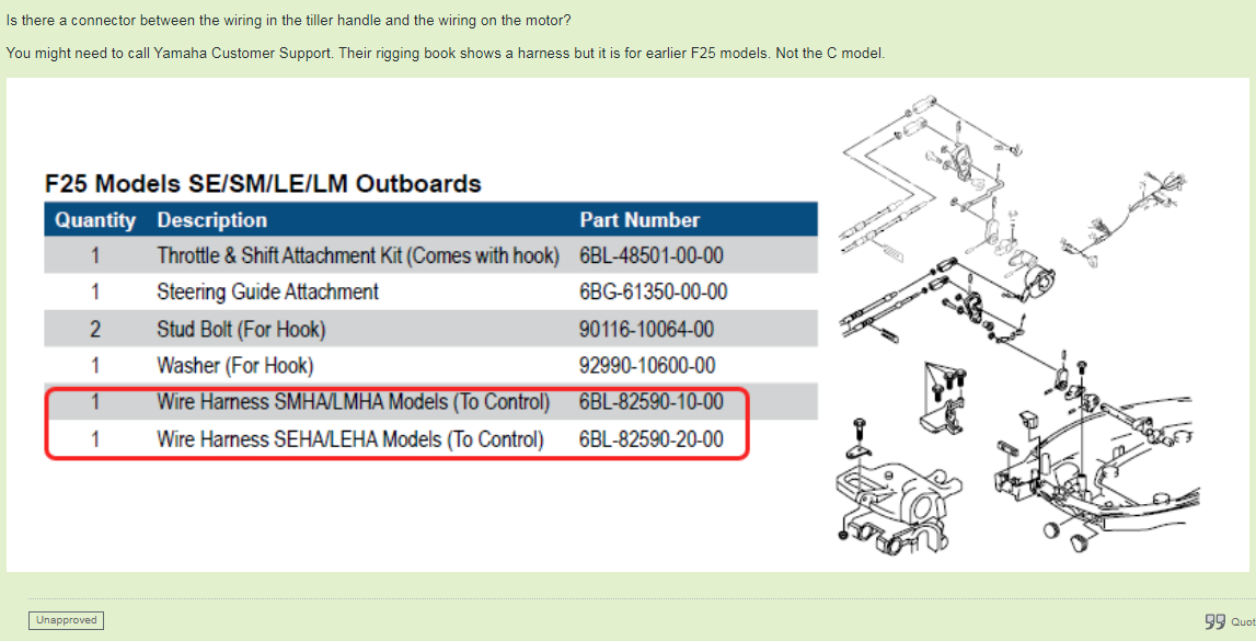

      Is there a connector between the wiring in the tiller handle and the wiring on the motor?
      You might need to call Yamaha Customer Support. Their rigging book shows a harness but it is for earlier F25 models. Not the C model.

                Is there a connector between the tiller handle wiring and the motor wiring? I don't think so but you are there.
