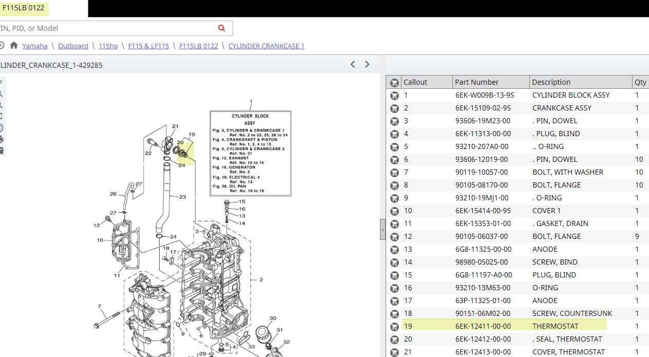

Can someone help me to find where is the thermostat located on F115 4 stroke 2021? I have looked from everywhere but I can't find it. My engine cooling system is not working and I have to check the thermostat to see if it's stuck. I have connected the hose to the engine flush port to for static flush without engine running as well as running engine submerged until above the water intake holes, but I don't get water out of tail tell. Please help me.
