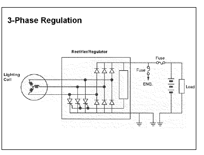

I believe the zener diodes are within the rectangle. That send current to the gates of the SCR's so they can close to shunt AC current to ground.

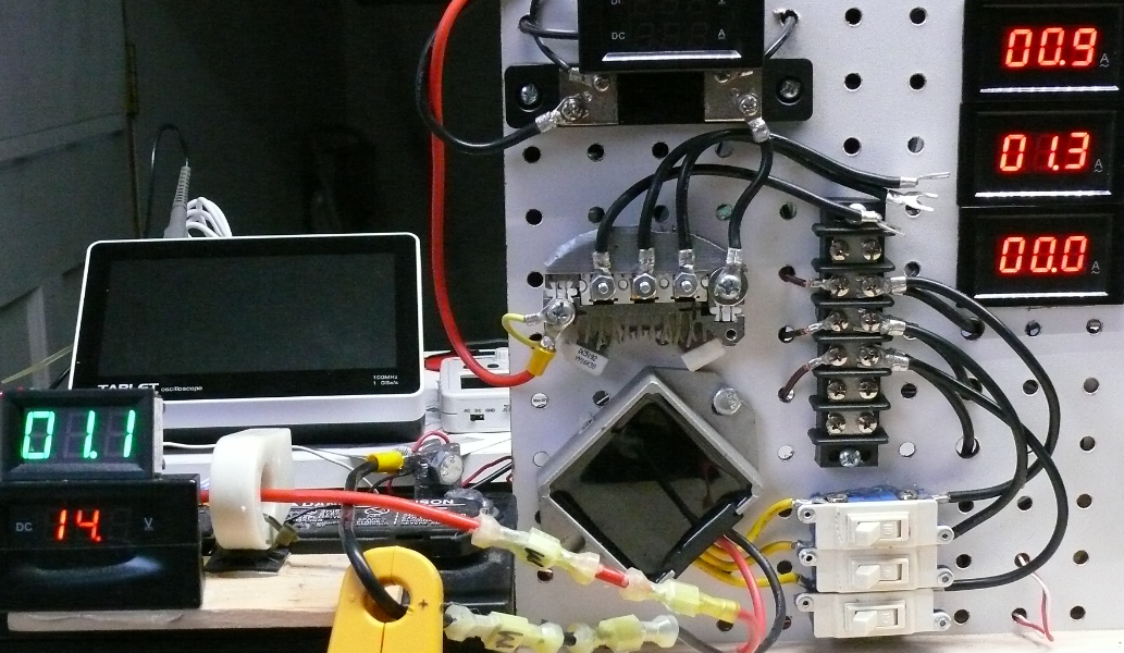

The Yamaha bigger lighting coils use a Y configuration. The 3 phase PMA that I have uses a delta configuration.
I lament not having an old Yamaha block with its flywheel and lighting coil installed so I could see what is to be seen with it. Oh well.
You are asking questions well out of my pay grade.
My belief is that with no voltage to the gate there is no current flow through the SCR. Once the gate has a voltage applied to it (via the Zener diode I believe) the SCR allows voltage to be shunted from the coil to ground. Thus keeping the voltage down
https://www.electronics-tutorials.ws...thyristor.html
This seems to be a pretty good theory of operation for a shunt type of rectifier/regulator. Although it does not go into details as to how the switching from the AC to ground gets done. No mention of zener diodes or SCR's.
https://www.electrosport.com/pages/t...g-system-works
