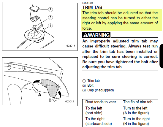

If the trim tab is adjusted properly then at your cruise speed and chosen trim angle, there should be no tendency of the motor to want to turn in either direction. The right/left turn effort should be the same.

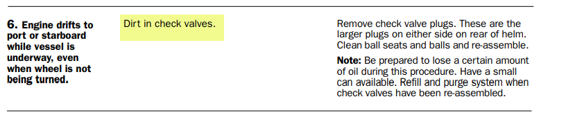

From what I am reading from Seastar, the check valves are the problem. Need to be cleaned. Then drain, purge ad refill the system.
