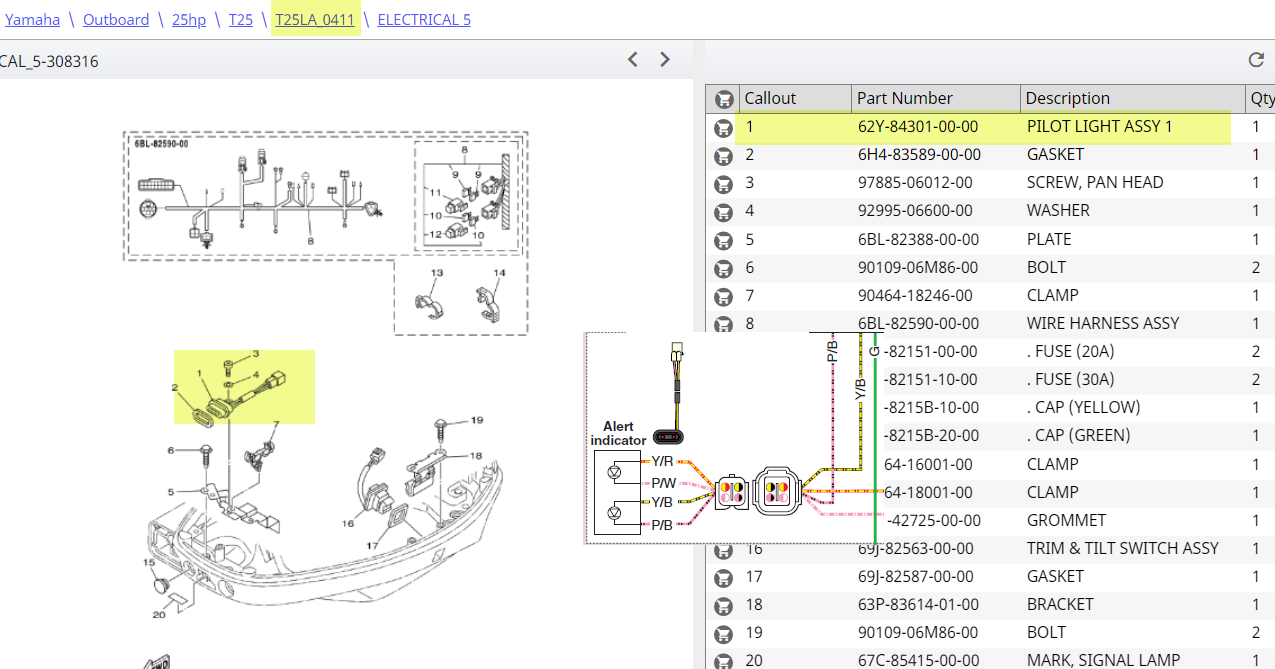

                    Looks to be the equivalent of a USA model T25A.
                    Does your motor have two warning lamps at the front of the bottom cowl? It appears that you can disconnect the coupler to the cowl mounted lights so as to connect a wire harness that will run to you tachometer.
                    A simple modification may be needed to the tachometer.
                        I have two led light temp. and oil. but on the tachometer there are two ordinary light bulbs
