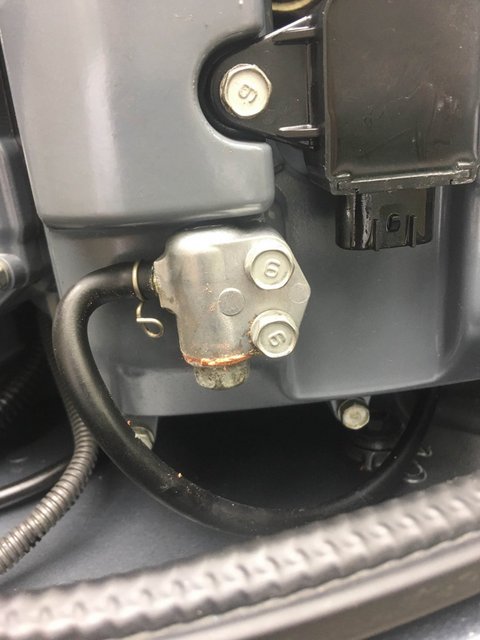

yes - although the sensor required (one for each motor) is a bit pricey:
https://www.boats.net/product/yamaha/69J-8A4L0-15-00
There is a plugged-off port currently installed on the rear starboard side of the engine;
you remove the plug,
replace it with one of the two bushings that comes in the kit with the sensor,
then thread the sensor in to the bushing.
Nearby is a capped-off electrical lead with a white "W" label;
you remove the cap,
and plug that lead to the sensor.
Having done that,

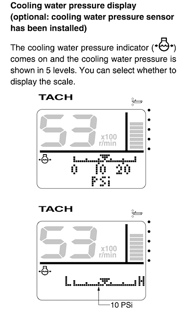

the water pressure will be displayable on your square tach
thank you very much ..... you are right about being a little pricey but probably a much better way to do it.. But this sounds lke a better idea than the costs Involving stand alone gauges and sensors and the time to run wiring or hoses ...... the pictures really explained it !! thank you
