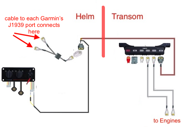

I am assuming I am going to need TWO Yamaha multi-device hubs where each engine's main bus connects to its respective hub and then I am also assuming I can merge both hubs by using a main bus harness between the two hub's BUS ports?
The idea is to eliminate ALL GAUGES in order to install two 12" chart plotters (Don't have room with the gauges in my console) and view all my engine and fuel information on either screen. According to Garmin, I can connect one J1939 cable and have that shared to the other screen via NMEA2000 and/or the Garmin Marine Network. Also, where would I connect the fuel sender lead...to the Yamaha multi-device hub? It looks like it's a different BUS type connector than the DEVICE type connector.

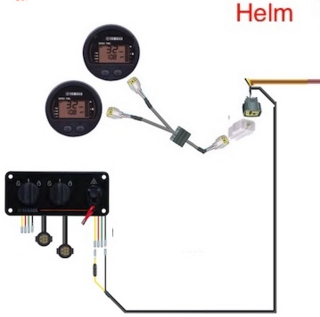

So far, I have invested considerable time making these two diagrams:
HOW IT'S CURRENTLY RIGGED:
HOW I THINK IT SHOULD BE RIGGED TO CONNECT TO GARMIN:
