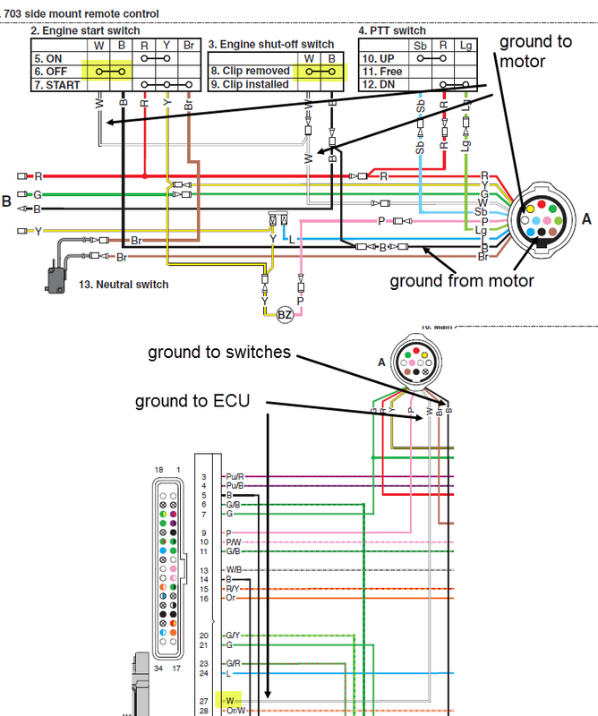

    need to check on the ground wire that the key switch and kill switch uses to ground out the spark voltage to kill motor,
    but I have no idea if turning the key off should shut off fuel pumps or what kind of ignition system that 60 has.

              • #8
                It should be unable to make a spark (and so stop) with the kill switch out.
                The kill switch works by literally grounding the spark to the case.
                Does the kill switch have it's gorund wire properly attached. ?

                  It looks to me that the kill switch is just a jumper to the ignition switch?
                  They are part of a small panel/component that I replaced.
                  • #10
                    It is.
                    Time to see if the ground is making its way to the kill switch and ignition switch. Time to go the motor to see if the ground applied to the white wire by the ignition switch and/or the kill switch is making its way down the ten pin harness. To the connector. If so, then see if the ground is making its way to the ECU.

                        Ok found the issue (sort of) white wire connector from boat at the motor seems to be the fault. I opened the connector, closed it now key shuts off motor. Feels like a good solid connection but will replace it at some point. There are only two wires that leave the connector a white and a blue.
                        • #13
                          Wrong white wire.
                          See the diagram again.
                          • #14
                            OP, should be the 10 pin connector,
                            not sure what connector you are talking about with only 2 wires in it
                            • #15
                              I’ll check again, there is a 4 pin connector with only a white and black coming out of it, that’s the one that I was able to move to get the ignition switch and kill switch to operate normally.
