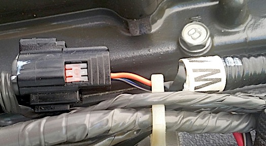

Let's start with the trim. Assumption being the only trim indication is via the MFD.
Do you know of the two pink wires on the engine that have to be connected for the trim to be displayed on an MFD? Are they connected?
If so, tilt the motor fully up so that you can gain access to the trim sender. Is the trim sender working as it is supposed to? That is, can it move freely? With the key on, and the MFD on, move the arm on the sender and see if the display on the gauge follows the sender.
Is the trim cam securely tightened in place?

It appears there is an issue with the tilt sending unit. We can cause the tilt level indicator on the Garmin display to move by using a finger to press on the sending unit arm. It appears that the spring is not keeping the arm in contact with the engine as it moves through the tilt cycle. A new trim sender will be installed.

Tilt sensor had a spring with some corrosion on it that prevented free movement of the sensor arm that should remain in contact with the engine during the tilting cycle. We cleaned and applied anti-corrosion lube on it. Thanks to boscoe99 for the guidance on this.
