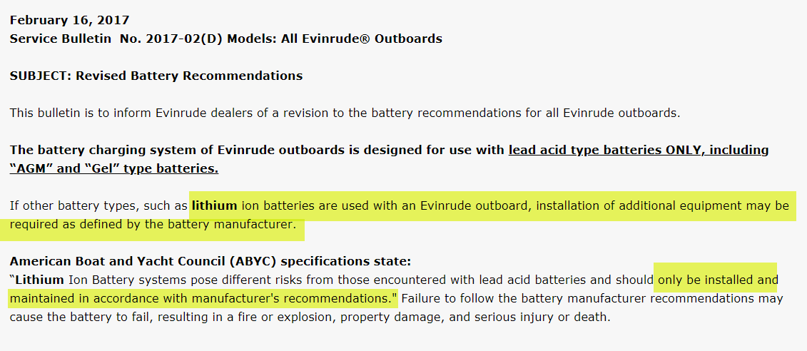

I liked Evinrude's approach. Put the burden on the battery maker.
Battery makers have stepped up IMO.
