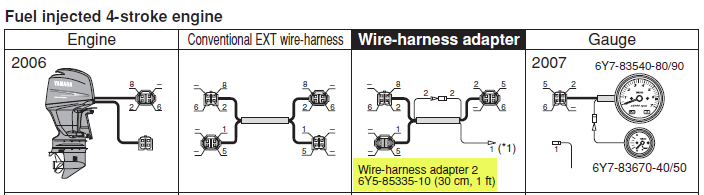

              I'm trying to do this same conversion to analog gauges on a 2005 F115. My gauge only lights the oil pressure light when I turn the key to on. Shouldn't the water pressure light also come on?
              I have 2 plugs shown below on the motor. Did I good up and buy the single plug gauge and should have bought a two plug gauge?

                Fairdeal,
                Would you possibly be able to find the part # for the two plug adapter harness you mentioned? I believe my motor has 2 plugs and my gauge has one. I’m only getting an oil pressure light and no temp light so this may be my problem.

                  Some Yamaha analog tachometers have two lights. One for low oil pressure and one for over temperature. In some instances both lights will illuminate briefly when the key is turned on. If one of the two lights does not illuminate I would suspect a failed bulb. If the bulb is good then I would suspect a wiring issue.
                  A USA 2005 F115 would be an F115TLRD model. It should have one trim/oil connector. Like shown in the diagram above. What country are you in? F115 models delivered to other countries got the change from two four pin connectors to one four pin connectors later.
                  The gauge with the single four pin connector can be mated to a motor with two four pin connectors via the use of a Yamaha adapter harness.

                    Originally posted by Derrick929 View Post
                    Boscoe
                    What water pressure light? There is no water pressure light that I am aware of.
                      one of the two plugs is just for the trim indication
                      (the lower one, fully visible in you photo)
                      the other plug is just for the low oil pressure and overheat lamps.

                          I really appreciate you guys helping, I’ve been trying to search and figure this out but I’ve not had any luck. I apologize, i meant the over temp light not water pressure. I am in the US, let me double check the year, it may be a 2004, would that affect 1 vs 2 plug?
                            Change for US models occurred in 2005. A 2004 US model year motor will have two four pin connectors.
                              Ok, I made it home and was able to verify the year. It is a F115TLRB, which should be a 2003, it’s been a few years since I looked at the year model, I apologize for the confusion, I should have verified first but wasn’t at home. The details mean everything.
                              So is this my problem? Do I need the adapter harness you noted above to convert the two plugs to the single gauge plug so that both indicator lights function correctly? This would be great if ya’ll have solved this problem for me. I believe it may also help with getting my trim gauge to function properly too.
