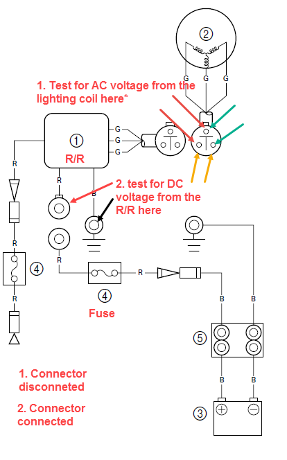

Was the lighting coil tested for output voltage? Ohms can be good but if the coil is shorted to ground the output will be down or non existent.
Yam has the lighting coil tested for peak voltage using a peak reading meter but your regular mutli-meter set to test for AC voltage will give you a good general idea.
Three green wires. A, B and C. A to B. A to C. and B to C.
Wiring diagram is in the service manual.
