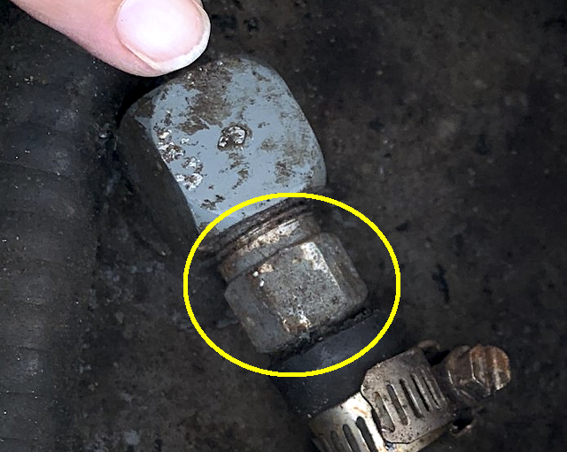

The Yamaha 300 had an issue today. It ran well for 1.5 hours, but as I was making my way home, the primer bulb collapsed and the engine would not exceed 2200 rpms. I was running at 3500 rpm for the 1.5 hours andI the engine lost power at 4500rpm's. I had a new bulb and all fuel filters replaced 25 hours as ago. Technician is going to look at the anti-siphon valve. Is this expensive and difficult to replace?
Originally posted by JimBen14 View PostIs this expensive and difficult to replace?
removing the antisiphon valve is not at all difficult,
so should not be expensive.
The part is simply a 'modified' hose barb -
an inexpensive plumbing part with pipe thread on one end,
which threads into the tank,
and a 'hose barb" on the other end,
to which is clamped the fuel hose that foes to the engine.
