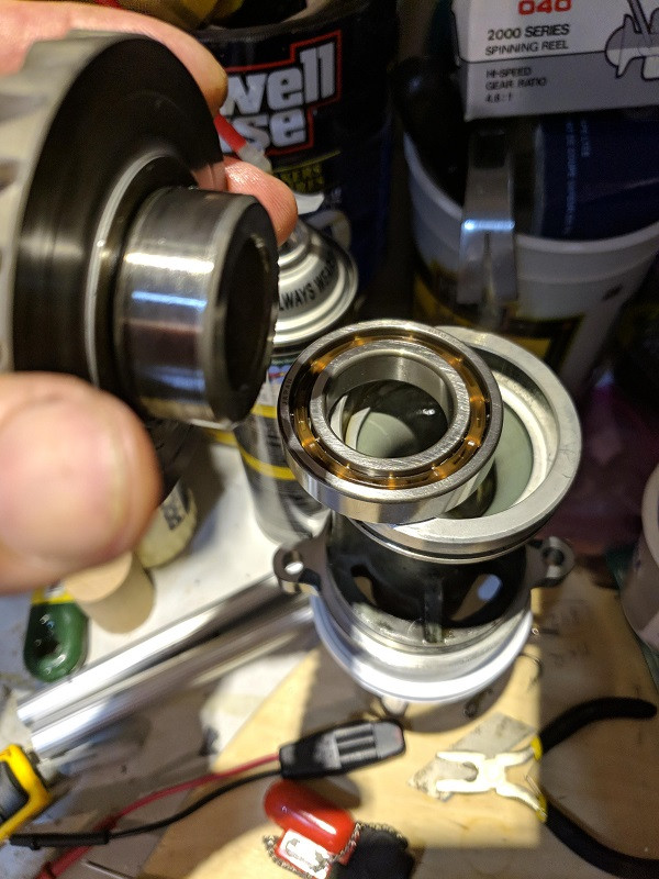

Took it all a part without any problems, but now I have question how to press the main bearing in.
The bearing is one piece and the race is not separated.
Also the new bearing is different then the old but still same Yamaha part.
Please advice on proper procedure

How tight was the old bearing coming off?
If it wasn't pressed on (with a press-IE, super tight) , you should be able to freeze the gear part of it (to slightly shrink the ID) and slip the new bearing back over it.
Obviously, you don't want to hammer the OUTSIDE edge of the NEW bearing, just the inner.
Also, if you Dremel out the inside of the old bearing (opening up the ID), so it slips over the bearing surface, you can use that old bearing INNER PART, to use in-between and hammer the new one bearing..
Ha! That is great ideaOriginally posted by TownsendsFJR1300 View PostHow tight was the old bearing coming off?
Thanks!
