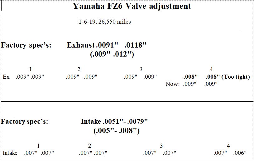

*I recently had to adjust the TWO exhaust valves (#4 cylinder-shim and bucket) on my Yamaha 600cc motorcycle (below pic) @ 26,600 miles.
They were too tight by .001". Had it been carboned up, the valves would have been looser. I don't run the bike as hard as it's designed to run and run Ethanol fuel. I strongly suspect the RF helped keep the clearances close to spec's. (The rest of the valves were dead nuts on across the board-4 valves per cylinder)
Synced cylinders after valve adjustment(spec's allow 10mms variance, within about 2mm's):

I'm not using a .001" gauge, but gauges between .005" to a .012" feeler gauge. Cylinder #4 was definitly an .008". Didn't want to cook a valve, the bike ran good.
**On cold mornings (yes, down here-maybe 50F), I would sometimes get a valve tick on start up, maybe 3 seconds long... That's now gone.
Guess that little bit of extra clearance got some more oil (semi synthetic) in there.
The "spec" sheet before and after:

I used a feeler gauge and micrometer to measure shim thicknesses, the old, vs finding another (shim kit) .001" thinner.
My experience on working on older bkes has been much less clearance on the valves...my old bike was only .002" to .004" on the valves. And I have seen them close up to no clearance at all...and burnt valves.
Having saying that I don't see how you would have burnt a valve with .008" of clearance. The valve was closing completely with room to spare. But that is what your manual says to keep them at, then that is the right thing to do.
Thanks for the clarification.

I understand better now that I see the specs. That's quite a bit of clearance on those valves. I was thinking you were down to only .001" clearance on one cylinder.
The whole job was about 6 hours, most of it just getting to the cams (Fuel tank, battery, coils, spark plugs, battery box, lots of wires, etc)... Figure another hour "adjusting".
She's good for another 26,600 miles and I KNOW it's been done.

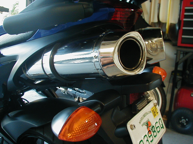

I don't remember valve spec's on my other bikes (over the years), most were screw adjustment. With this higher revving engine, guess Yamaha opened spec's up a bit. The engine with the stock muffler is quiet as a sewing machine... Not so much now with aftermarket mufflers... A low growl under say 5k, after that, it screams..
