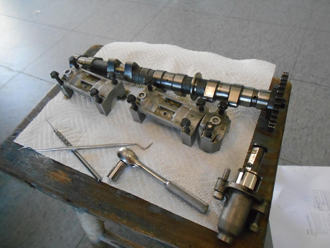

*I recently had to adjust the TWO exhaust valves (#4 cylinder-shim and bucket) on my Yamaha 600cc motorcycle (below pic) @ 26,600 miles.
They were too tight by .001". Had it been carboned up, the valves would have been looser. I don't run the bike as hard as it's designed to run and run Ethanol fuel. I strongly suspect the RF helped keep the clearances close to spec's. (The rest of the valves were dead nuts on across the board-4 valves per cylinder)
Synced cylinders after valve adjustment(spec's allow 10mms variance, within about 2mm's):
