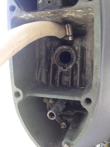

Given the model & year of the motor,
the symptoms are classic for the notorious exhaust rot:
a hole eaten through the exhaust passage allows cooling water to escape -
acting as an additional always-open poppet.
Its easy to check for leakage,
with the LU off and the motor tilted up,
clamp the end of a garden hose to the metal water tube -
then turn on the water.
You'll see water coming from numerous small holes and vents all over the LU -
but there should NOT be any water at all coming out of the large 7-sided muffler opening
if there is, you have serious corrosion in the engine exhaust passage -
possibly even the bottom of the engine block.
