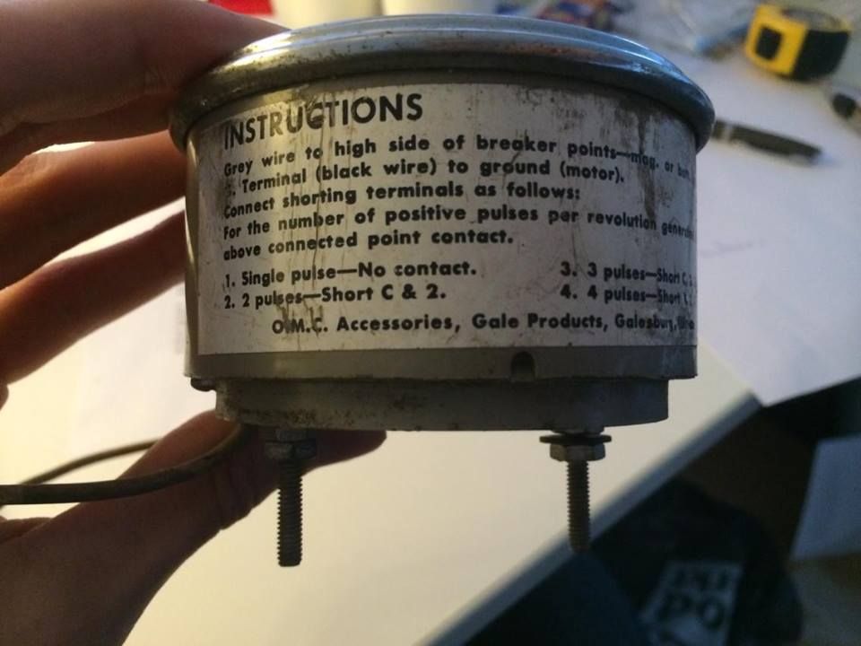

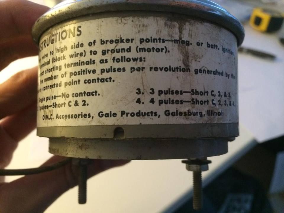

Hey everyone,
I recently bought an OMC Tachometer, and was wondering how I can hook it up to my Yamaha F9.9BE. The instructions refer to the pulses per revolution.
Pictures for reference:
Thanks again!
Cheers,
Paul
