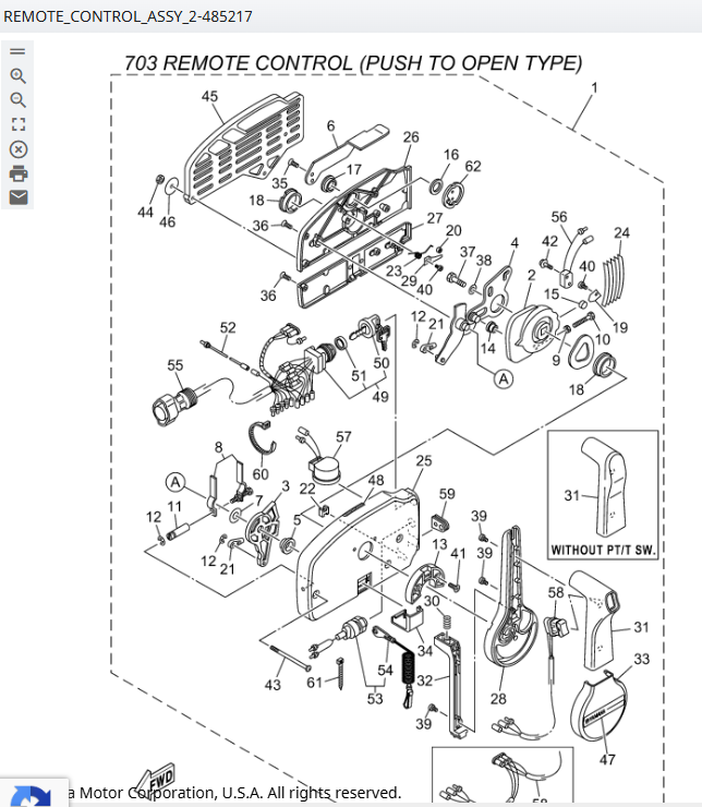

    my nearly new 703 remote control is stuck in nuetral and will not shift into forward or reverse. the problem seems like it is in the 703 control box, not in the cable. the "nuetral interlock trigger" could be the problem but it feels like it is attached and working. what else could be locking the shift?

    you should be able to see if the lever you pull up is moving the lockout
      was working fine last time i ran the motor. nothing changed. i will take the box apart. do you know where i can find a diagram of the parts?
      i found a utube which will be helpful : https://www.youtube.com/watch?v=WlmCjelHH5c

        I have no idea about a part break down for the 703
        • #5
          breakdown of the 703 control box can be found in the parts catalog section (under rigging) at www.yamahaoutboards.com

            thanks for parts diagram boscoe
