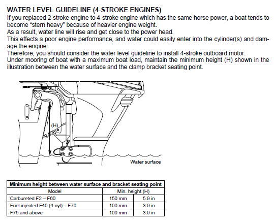

    1. How far above the waterline does the exhaust relief port have to be? If I upgrade to a F90, the bigger motor weighs an additional 99lbs or so. I have attempted to simulate this weight by sitting on the cowl with my dog. Together, this is about an additional 220lbs in weight. With this additional weight, the lower exhaust relief port is still about 3.5" clear of the waterline and upper one is about 7". Is this sufficient?

          Thanks so much, Boscoe99, that is very much appreciated. Sorry for the delay in responding; just been a little caught up in a few other things.
          That's very useful info. Perhaps I was just worried about nothing because I definitely have more than the prescribed 3.9" clearance between the water surface and the bracket seating point!
          I have also recently spoken further with my local Yamaha dealer who also believes that there should not be any issue, so hopefully it will be all good!
