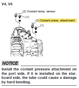

be extremely, super extremely, careful removing the plug. very little thread on aluminum block, and plug is steel. and corrosion is possible. if you cannot remove it with minimal torque applied, then abandon it.

Put down the bong and push your chair away from the keyboard.Originally posted by amahaork View Postutterly useless feature. follow motor maintenance schedule and pressure always will be good.
Have you never heard of a water pump failing to do its job between service intervals? Some boat in sand, mud and muck and the cooling system suffers.
Those that use a pressure gauge can get more miles out of their impeller. By monitoring the output via a pressure gauge. I could get three or so seasons on an impeller before the pressure would start to fall off. I then knew it was time to change the impeller.Last edited by boscoe99; 12-04-2024, 12:15 PM.

Where is the best place on the engine to attach the water pressure gauge hose. 2004 Vmax V150TLRCTags: None
