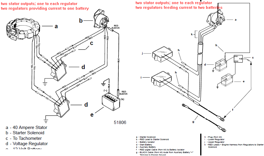

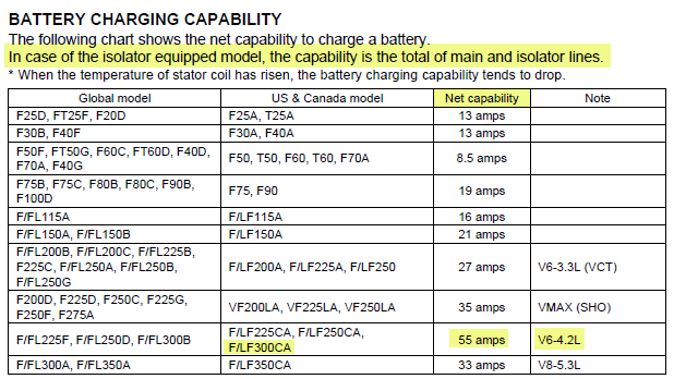

Sorry for a silly question but here goes:
On the F300, by attaching an auxilary charging lead, will the engine produce any more net amps to the battery?
For example:
There are two boats. Boat "A" and "B". Each boat has ONE F300 attached to a SINGLE battery. Assume no House battery.
Boat "A" has no auxilary charging lead installed. Just the Factory connection to the single battery.
Boat "B" however has an auxilary charging lead installed to the single battery along with the normal Factory connection.
Does the SINGLE battery on Boat "B" get any more charge or amps than Boat "A"?
I think not. Correct?
For example:
