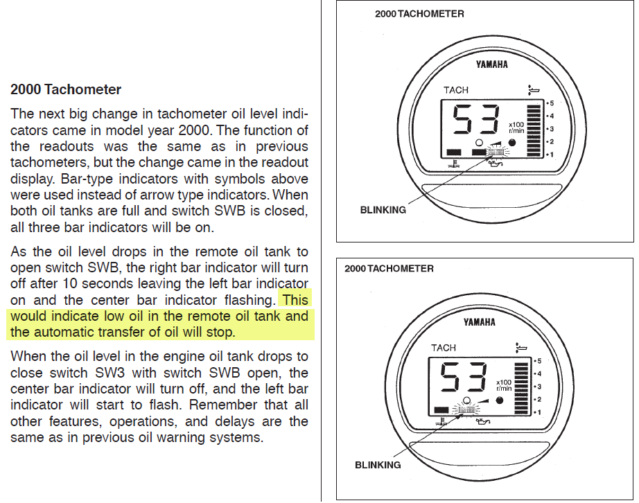

The situation: Motor runs fine for 30 minutes or so then goes into RPM reduction mode three flashing bars on the gauge with audible alarm. I pull the cowling and engage the emergency switch and the main tank fills up quickly. I'm back in business. I am convinced this is NOT an oil flow issue but an electronic one.
The owner's manual says 3 flashing bars with alarm is battery or oil flow blockage. Battery is new with secure connections and no corrosion. The filter on the remote tank is new. Removed and cleaned and pushed compressed air through it. Tank was drained as well. Oil was clean. No sludge anywhere. Boscoe/rodbolt, one of you said (in the above mentioned post):
a quick test, simply drain the engine tank, turn the key ON.
look at the tach.
you should have an audible and 3 bars flashing.
This is what I see.

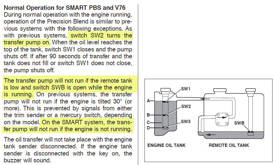

I verified the oil sensors were good:
Main oil level assembly:
Upper float:
Up: Blue/green open, blue/white closed
Down: Blue/green closed, blue/white open
Lower float:
Up: Blue/red open (both)
Down: Blue/red closed (both)
(I've since learned these are called SW1, SW2, SW3)
Remote oil level assembly (black and black/red):
Up: Closed
Down: Open
ECU pins to harness (values in ohms):
pin 21 - black/red: 0.9
pin 24 - yellow: 0.0
pin 17 - blue/white: 0.7
pin 18 - blue/green: 0.4
pin 4 - blue/red (1/2): 0.4
pin 5 - blue/red (2/2): 0.0
pin 9 - black to 10-pin connector: 0.9
pin 9 ground test with black jumpered to black/red WITHOUT 4-wire remote harness: 0.2
pin 9 ground test with black jumpered to black/red WITH 4-wire remote harness: 2.0 <-- problematic???
pin 20 - blue to emergency switch: 0.0

Test 1:
1. Jumper black to black/red
2. Test light across blue and brown
3. Key on
4. Turn on emergency switch
5. Light comes on
Test 2:
3. Remove main oil level sensor position floats in up position
4. Start engine (idle)
5. Move upper float downward
6. Light does NOT come on <-- not expected result
Some other things in no particular order and information because of other posts/responses:
I'm not a Yamaha mechanic but I see "remote tank full" and "I need more oil" above. True?

- I have a Yamaha service manual for VZ250/VZ225 (LIT-18616-VZ-20). There's no mention of the oil system in it. It has wiring diagrams in the back (quite helpful).
- I have a copy of "Oil transfer pump troubleshooting chart". I'm literally at the box that says "OHM test the engine wiring harness" then "Replace the control unit". Not where I want to be.
| Oil level switch (remote tank) | ON | ||
| Oil level switch1(engine tank) | OFF | ||
| Oil level switch2(engine tank) | ON | ||
| Oil level switch3(engine tank) | OFF | ||
| Water temp switch (overheat) | OFF | ||
| Battery voltage (12-16) | 13.99 | V | |
