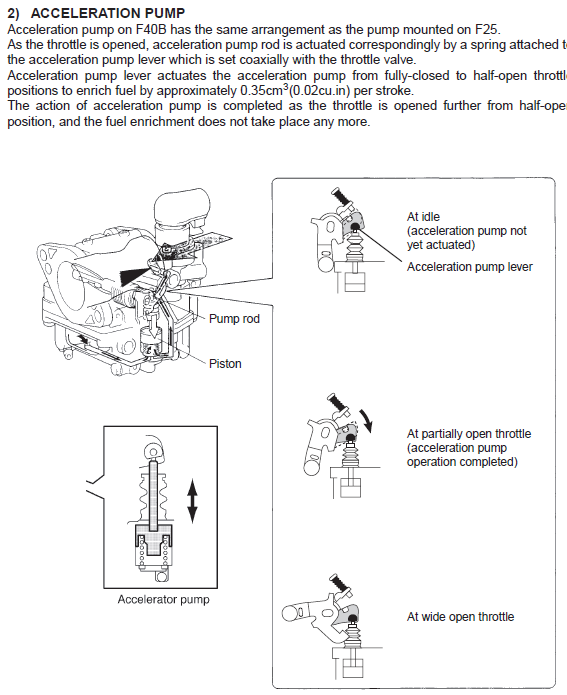

An F40BET model was not offered in the US by Yamaha USA. But it is similar if not identical to the US F40BTLR model. Which indeed has an acceleration pump.
Remove the intake silencer. Look at the inlet to the carburetor. Specifically at the horizontal nozzle. Quickly advance the throttle. If you do not see gasoline spray out then the carburetors need to be cleaned. More than likely in a heated ultrasonic cleaner. Completely dismantled. By someone that knows what they are doing.
