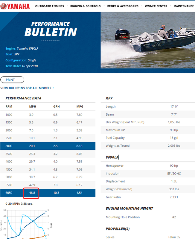

My question is that regardless of how much I search, aside from slightly different gearing I'm not coming up with very much information on actual differences or performance specs.
I'm not finding very much real world comparisons or experiences with the 90SHO either.
I'm hoping a few members here have some first hand experience and can also steer me in the direction of prop pitches and what to expect on a 16ft boat that got 33mph with the 70 (when it would finally get on plane)
