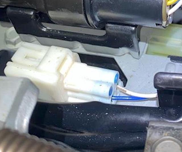

                          Sorry for the influx of photos, is this it after further looking it was connected to the alarms on the tiller arm and Definetly looks close but not white and different cable colour coming in? If it’s not that it doesn’t exist haha
                            No, that is the "Trim & Oil" Plug, connected to the "Trim & Oil harness", it is for your analog gauge.
                            The Command Link plug looks like this - perhaps with some bright yellow tape on the wire jacket
                            There should also nearby be these (which you won't use since you already have analog trim gauge)
                              And on the side of the engine, two short harnesses with capped-off ends,
                              one with a "S" label, one with a "W" label.
                              If you have none of those four connectors pictured,
                              then it would appear someone has swapped a newer Command Link capable ECM
                              onto an engine with a pre-CL wiring harness
