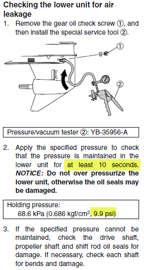

Following post getting this lower unit squared away. I pressure and vacuum tested my lower unit and the results are that the vacuum side holds solid at 10-12 PSI but the pressure test shows that when I get to 10 PSI it leaks down to 9 PSI before holding. I can't go above 10 PSI without a leak down to 9 PSI.
When I put my ear to the propeller cavity, I can hear the slight air leak which leads me to believe it is the prop seals are where the air is releasing.
this indicates to me that water intrusion can't get in up to 12 PSI vacuum, but the oil may leak out when things get heated up pressure past 9 psi. However, I am not totally sure that this test is accurate... is 9 PSI sufficient? Has anyone seen this before? What is the expected outcome for a 2009 Yamaha 250 txr?
