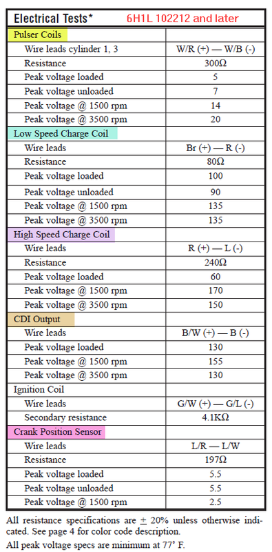

                          I'm so sorry. Didn't see any email alerts of new posts, and I've missed some really generous help here. Here goes...
                          What is the complete engine ID? Begins with the number 6.
                          6H1 - my engine serial number badge is:

                            Yamaha service manual voltages are peak voltages. You have measured and list RMS voltages. To covert from RMS to peak you multiply the RPM by 1.414.
                            Were your measurements taken with the components loaded or unloaded?
                            Your wire colours are not making sense.
                            The output voltages from the CDI to the ignition coils is not making sense. Very very low. Not surprised that there is no spark. It may be that the output is so quick that an RMS meter might not be able to adequately capture the voltage.
                            Forget the lighting coil. Has nothing to do with ignition.

                              PS - Thanks for that picture of readings above. Almost same as the manual I am using, except for "loaded/unloaded" which i think is equivalent to my books "open/connect".
                              Here is a direct link to the page of the service manual showing all the specifications/values my engine should be reading: https://www.manualslib.com/manual/10...page=29#manual
                              (Mine is the 90, far right side of all tables)
