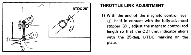

    Hello,
    Just enquiring regarding the jubilee clip; what should be there instead to stop the advance going beyond the mark. Something must be broken/missing, references online so far show a different layout on the CDI.
    Many Thanks.

    Hello, My motor 40H has a similar lay-out for the CDI. However, it is also retrofitted with a stack of washers instead of the original collar.
    find attached a page from the catalogue for a 50D engine.
    part 8: Collar 90387-06M19
    part 9: bolt 97313-06025

        looking at the OPs pics, should that have a full retard and advance adjustable stopper in that area?
        All I see if one, not both
          Looks to me like just one.
            I see a hose clamp being used as a stop. It took me awhile to see it. I guess that is a jubilee clip???
              Hose clamp is on the bolt with number 8 on the head in first picture
                https://www.google.com/url?sa=t&sour...3bGI1GdeyMdAvw
                  Learn something new every day...lol
                    so it sounds like the sleave that was supposed to be on the bolt fell apart or was lost, so they did a little rigging with what they had on hand.
                    I like the others post about some washers (hopefully they are the correct size to match what was there before.
