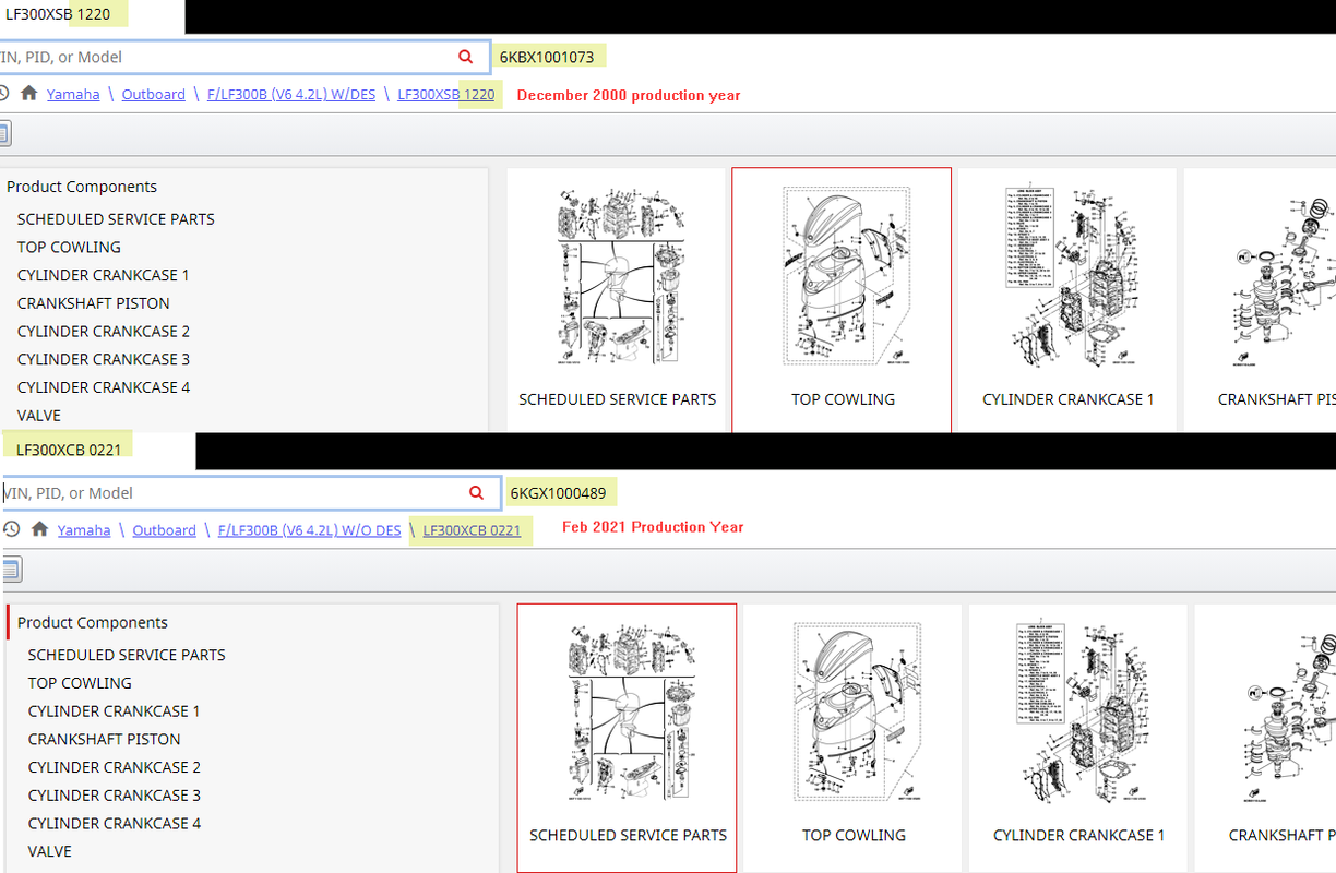

    It seems Yamaha no longer stamps their motors with the month and year of manufacture
    Below are two serial #'s from F300's built I think? in 2022 or maybe 2021.
    Can anyone here help me determine the build date for each?
    These are each Left handed rotations. One is a DES engine, the other is not.
    6KB X 1001073 for a LF300XSB <<< DES engine
    6KG X 1000489 for a LF300XCB

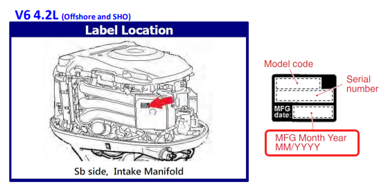

          Are you saying that the label on the motor is not there?

              Thank you Boscoe. Sorry but I didn't think to pull the hood and look for a label.
              I was expecting to see it on the outside upper bracket area.
              I think you meant December 2020 (not 2000).
              Appreciate your help! Thank you!

                Ooops. Yes, 2020.

                  Yamaha changed the labeling location for the month and year in 2018.
                  Like Walmart, just when everyone knows where everything is, they change it all.

                    maybe some were tired of the one on the outside being painted over or disappearing.
                    this is the 1st I have heard of that change, interesting and good to know.
                    thanks for posting that

                      To make it more difficult, the labels are on different positions depending upon the motor model.
