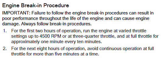

You posted concerning this topic either here or on TOS. The last time I tried to access an operator manual on the Merc site, it required a serial number of motor. A friend has the bug for a new boat. Offered with a 2023 F250 4.2 liter. I mentioned that Mercury break in was a tad more strenuous and IMO, better. Assume, guess and hope, the procedure is fairly standardized for their larger displacement motors. Would you be able to access?
