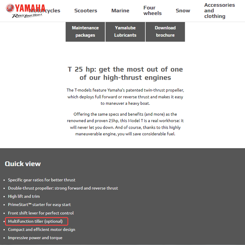

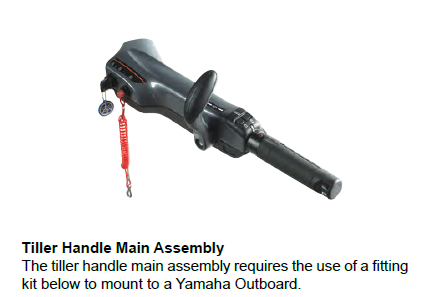

            Last I checked, France is in Europe. Here is a snap shot from a link to Yamaha motors being offered in France. One of which is the T25. That model can be equipped with the optional Yamaha multifunction tiller handle that has the trim and tilt switch integrated within it. Sounds like that is what you need. But...

                Thanks alot, thats what i was looking for.

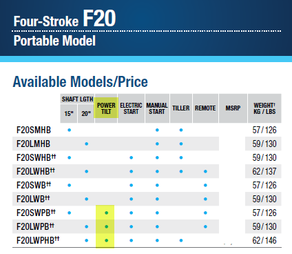

                      Our F20 models have too only power tilt and it will probably do the job i need.

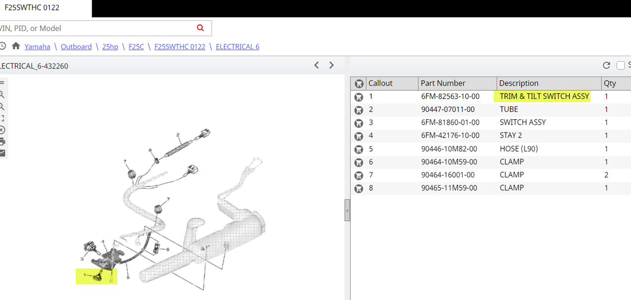

                      Other option would be using F25 parts as it has power trim and tilt. Problem is that i havent find short PTT models in spare catalogs to check parts. Only long shaft models. F25GETS is the model i need.
