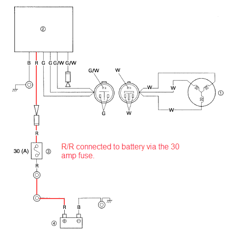

Ok so I had another thread going with some smoke and blown fuses. Figured I’d start a fresh one now that one part has identified itself as broken. Had a dead battery on thurs after boat sat for a week. Replaced it with new battery and hooked it up. Used trim to raise, then lower motor and then started it. Ran for 30-45 seconds then died. 30 amp fuse was blown, all electrics dead and could smell burnt wire. Looked everything over and couldn’t find any damage. Replaced fuse, and the second the negative wire was connected to batter to complete the circuit, rectifier caught fire. Wires were connected properly to the battery and the fuse blew again. My questions are: should the rectifier even had power to it without the key being on (key was in my pocket). Could shorted rectifier have drained my battery last week? Is the rectifier the actual problem or was it a victim of another relay?

I was not aware that that f80 had a generating system and R&R that put out less than 30 ampsLast edited by 99yam40; 07-10-2022, 10:30 AM.
when did the F motor go up in amperage, maybe I was thinking of larger F motors?
I also thought it strange that the 30 amp fuse did not blow when the RR went up in smoke and fire
It did blow. I can’t say exactly when but as my buddy was connecting the negative terminal he noticed the fire right away and pulled it off. Don’t know if it took a fraction of a second, a second…whatever. when all the commotion was over I checked the fuse and it was blown.
