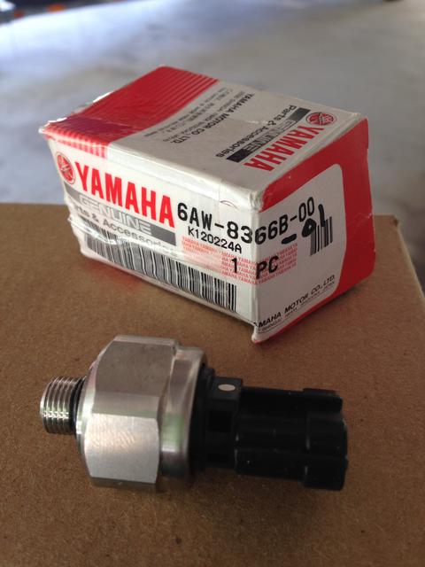

Once you've found the sensor connected to the black rubber pitot tubing,
you can do several things:
- check that the opening of the sensor is not plugged with debris
- try forcing air or water 'backwards' through the rubber tubing to confirm the pitot is clear
- if necessary replace the sensor:
