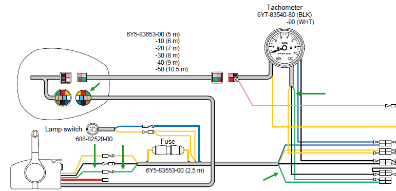

Hey everyone I have. 2009 90 four stroke outboard and currently trying to wire a tachometer. I spliced into the green wire in the main harness that goes to the throttle control box and followed the directions on the tachometer instructions. Wondering what I am missing? Thanks

the problem is we have no idea where you got your power and ground (if they are good ones when key is in the one position)
have you checked to be sure they are good and the tach powers up?
we also have no idea what tach you have and what you set it to for your motor
Yup I verified the power is from a key source (yellow) wire in the Yamaha harness and the black ground and used the green tach signal wire.
