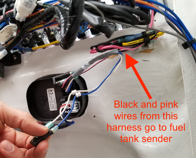

I just re rigged my boat with mechanical 2015 f150s & 6yc.
I hooked up the sender to the command link hub, set the second tank to unused, set the main tank to 175g and attempted to do either a single or multipoint calibration. Either way I get an error message the calibration could not be completed because the sender was out of range. I verified 115 ohm output from the sender and that the signal was true all the way up to the hub.
Tank is roughly half full so the 115ohms seems in line with what I was expecting.
I believe it’s an abcy us but tried the eu as well. Results were the same.
I also tried a local reset on the gauge and tanks.
