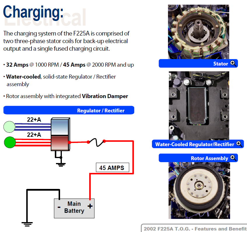

Yes, its "a 45 amp alternator"
- the max it can generate, which occurs > 3000 rpm
~2.5 goes to the lift pump,
~4.5 for the high pressure pump
plus spark coils, injectors, which increases with rpm
and the ECM/sensors take some

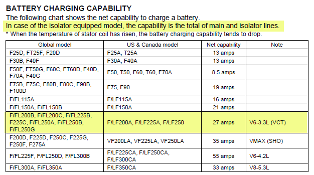

I can't recall seeing a Yamaha published "net output value" for the 2005 F225
There is a published 27 amp net value for the later 3.3 F225A
but that has oil control valves for the VCT
and twice the number of spark coils
My suspicion is the original F225 then is higher than 27 amps
but can't state with certainty
