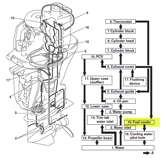

                  so if you are just referring to how hard the telltale is pushing water out, I would be looking at the other things that the water runs thru before exiting.
                  I am guessing it runs thru a fuel cooler, but I am not positive
                    It has a fuel cooler. Might want to check the hose all the way back to the exhaust cover.

                            Checked tubing from fitting below the Thermostat through the fuel cooler to the tell tell no blockages able to blow through it without any resistance. Pulled the tube off this fitting while running on muffs only a trickle
                              did you pull it off at the exhaust cover also to compare flow rates?
                              that would tell you if there is a flow problem coming out of the motor or just out of the cooler
