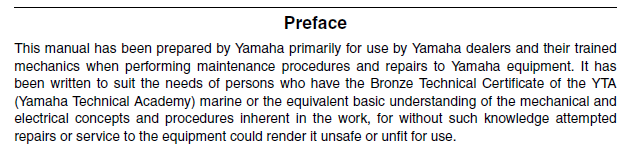

Right or wrong Yam service manuals are written for mechanics with some degree of Yamaha basic training. They fail to include every possible thing that might be needed.Originally posted by Sean Allen View PostThanks fairdeal, I'd seen that but I was expecting a specific setting for the housing.

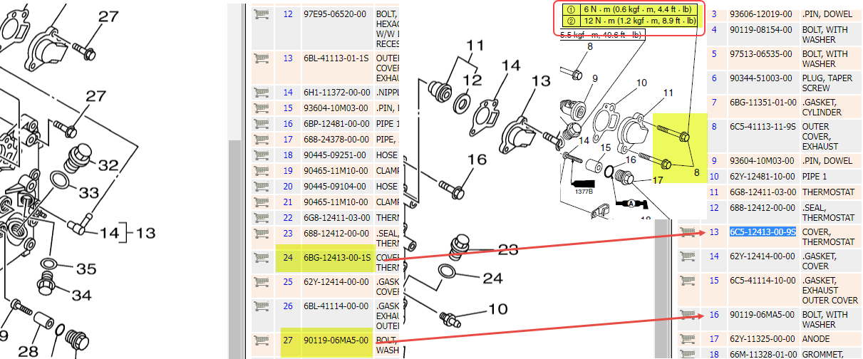

What a Yamaha mechanic might do is to go and see what other models use the same thermostat housing cover and attach bolts. He might then look in other service manuals to see if the torque values are specified for those particular bolts in that particular application.
Which I have just done for you. Lo and behold, the F25LA service manual gives you exactly what you are looking for.

I have the F40LA and the thermostat bolts are a 2 stage torque. My service manual notes 4.4 lb. ft. as the first stage. this ensures that the gasket is firmly set in place. then, the second stage of 8.9 lb. ft. I would set your torque wrench to 85 ft. lb. so you do not overtighten much when it clicks. A digital torque wrench rated for low torque is ideal here. I use the Snap ON ATECH 240 rated for 240 inch pounds (1-20 lb. ft.). That housing will crack if overtightened and apply a VERY light amount of grease to the threads since grease will skew torque specs. The manual does not call for grease or any thread locker. If you grease them, apply 85% of the second stage (7.5-8 lb. ft.). That manual assumes that you clean the bolt threads, check the mating threads and ensure they are clean and torque dry with a bolt that is not damaged or deformed. Otherwise, it is assumed you will use new bolts.
It was a typo. 8.5 lbs.-ft. for stage 2. the Snap On 240 ATECH gets this done. Use a quality calibrated digital torque wrench, with clean bolts with a little grease applied. Combine this with cleaning the mating surfaces and you will not have an issue as long as the bolt threads are in good condition and the bolts are not damaged. The digital wrench only has a total capability of 20 lbs.& 8.5 lbs.-ft. is only 43% of its total capability.Last edited by byron.akhavi@gmail.com; 05-22-2022, 09:54 PM. Reason: Typed the 2nd stage setting incorrectly.
