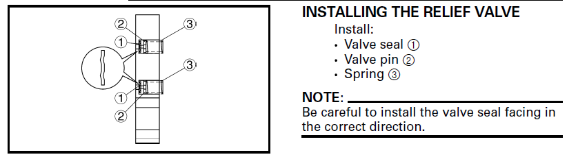

I have a 2003 yamaha T8 with power tilt does anyone know what way the seal for the up and down relief valve faces Thanks dkt60012
T8 power tilt
Cardinal rule... always take notes and/or pics as you disassemble.
It's sometimes visible in parts breakdowns - check your service manual or use the link at the top of this page.
BUT... springs face the liquid you want to keep out. In this case, you want to keep sea water out.2000 Yamaha OX66 250HP SX250TXRY 61AX103847T
Originally posted by dkt60012 View PostThe rubber seal has two different sides to it I know where it goes not sure which way to face the seal any help would be great Thanks dkt60012
The cardinal rule isn't just about WHERE to put it back in, but also how to ORIENT it.2000 Yamaha OX66 250HP SX250TXRY 61AX103847T

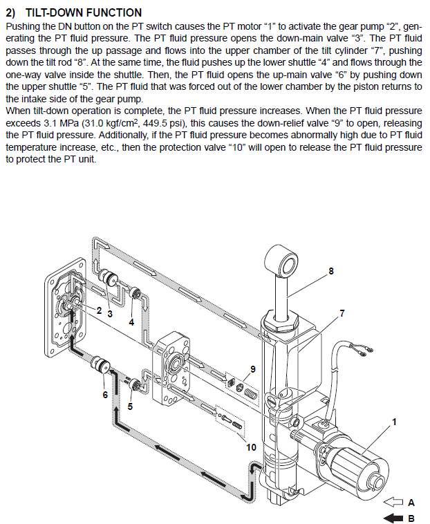

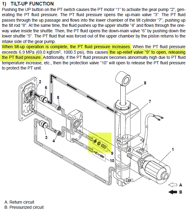

is 10 also considered the down relief valve?
10 is not the down relief valve. 10 is called a protection valve.
Here is the down relief valve.
I am very confused now, how can #9 be the up and down relief valve and open at different pressures depending on up or down direction?
looking at it harder, it seems #9 up relief valve is not in the same position/ location as the #9 down relief valve,
so it is not the same valve after all
kind of confusing to meLast edited by 99yam40; 01-19-2022, 08:39 PM.
Originally posted by 99yam40 View PostI am very confused now, how can #9 be the up and down relief valve and open at different pressures depending on up or down direction?
