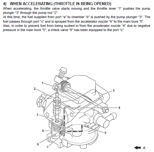

I have a 2016 F8SMHB and was just looking over the parts diagrams between it and the F9.9SMHB. There are some difference external to the engines but in terms of power, it looks like everything except the carb jets are the same?
Is it really that simple to go from 8hp to 9.9hp? Am I missing anything?
