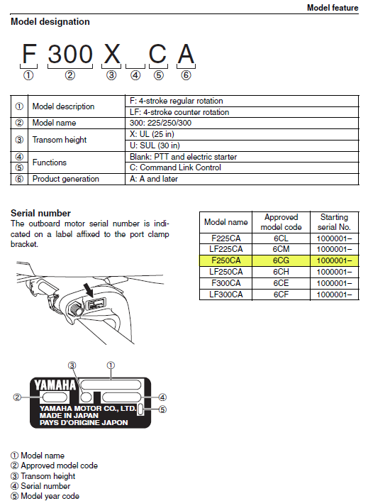

        6CG points to a digitally con*****ed 4.2 liter F250. Equivalent to a USA model F250XCA. Known here as an "Offshore" model.
        The 3.3 liter F250 has a 6P2 prefix.
        A serial number starting with 1001 tends to indicate a 2011 production year motor. There should be a decal on the motor with the month and year of production.
          Your local Yamaha dealer should know exactly what service manual is applicable to your specific motor.

                  If it has a 6CG prefix it is definitely the bigger block 4.2 liter model.
